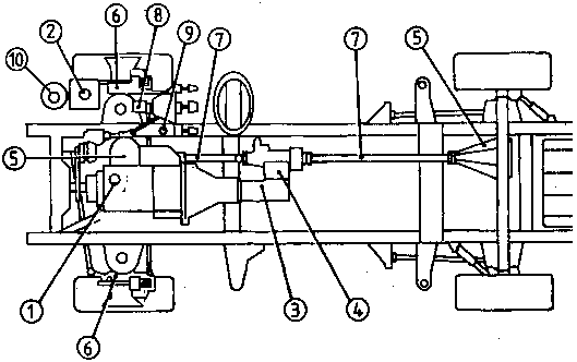

OLII, FLUIDI E GRASSI
| DOVE | SPECIFICHE | |
| 1 | OLIO MOTORE | TURBO DIESEL SAE 15-40 |
| 2 | FLUIDO REFRIGERANTE | IDONEO PER MOTORI IN ALLUMINIO |
| 3 | OLIO CAMBIO | ATF M2C33G-F |
| 4 | OLIO RIDUTTORE | SAE 80 IPOIDE |
| 5 | PONTI | SAE 80 IPOIDE |
| 6 | FUSELLI A SNODO | SAE 80 IPOIDE |
| 7 | ALBERI E GIUNTI | GRASSO |
| 8 | POMPA FRENI | FLUIDO PER CIRC.IDRAULICI DOT-4 |
| 9 | POMPA FRIZIONE | FLUIDO PER CIRC.IDRAULICI DOT-4 |
| 10 | OLIO SERVO STERZO | ATF M2C33G-F |
